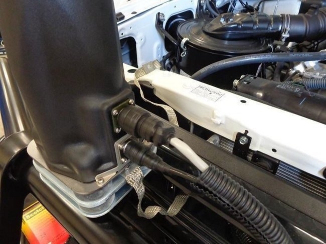

Principal lay-out of the HF radio accessories and cables installation in the specific vehicle models;
